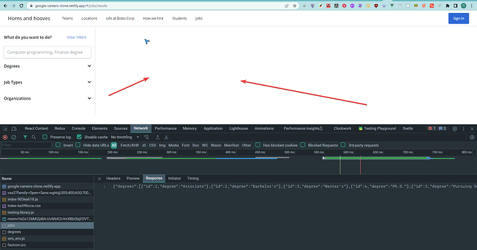

i am accessing my json data:
but for some reason they, this data, are not displayed:

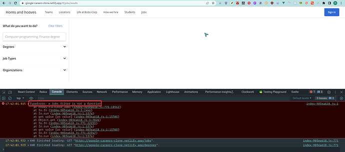

I found this message in the console:
TypeError: e.jobs.filter is not a function
I display a list of vacancies (“jobs”) by applying a selection to it:
it’s probably something to do with the redirect I specified in the netlify.toml file, but I can’t figure out exactly what the problem is.
the problem is “TypeError: e.jobs.filter is not a function at Proxy.FILTERED_JOBS”:
it comes from this code:
There’s not a direct correlation between your application code and the API/JSON data, so getting it to return a value doesn’t guarantee that no other code in your application will fail.
It’s not.
This says at that point in the execution that jobs is not something that has a filter method, in your case that it isn’t the Array you expect it to be.
This is likely because while you’ve created routes for /jobs, /degrees, /spotlights, you’re routing them all to the same /.netlify/functions/jobs function, which always returns the top level Object from your JSON data.
You can confirm this by visiting:
https://google-careers-clone.netlify.app/jobs
https://google-careers-clone.netlify.app/degrees
https://google-careers-clone.netlify.app/spotlights
If you’re expecting those to return only their matching key from within your JSON data, then you would need to adjust your function logic to account for that.
