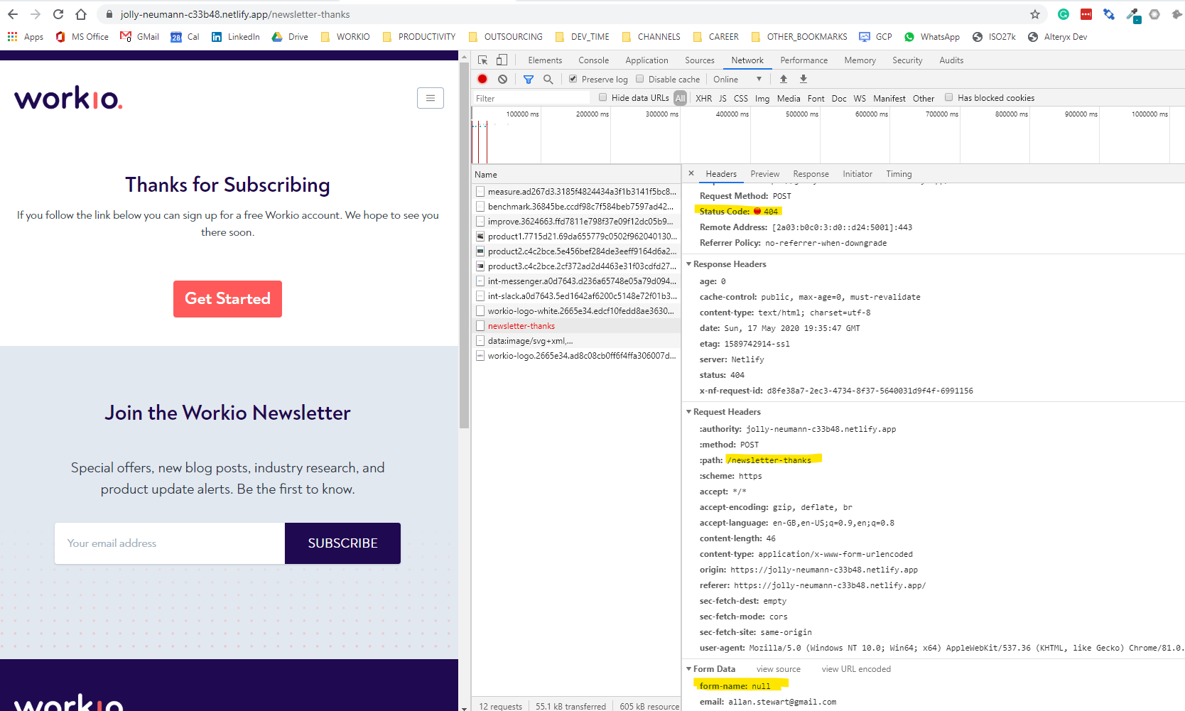

Hi @jonsully and @jen - so sorry to bother you again, but I’m still having trouble getting this form to work. As a reminder, I’m using Gridsome and have been following their guidelines here Add a form to Gridsome - Gridsome. It all “seems” to be working, with the action page loading, but I’ve noticed that my fetch is giving a 404 error, its so strange. I’ve attached an image, highlighted bits of interest in yellow, that shows both the action page loaded on the left, and the strange 404’s, null form name data on the right -
The /contact form work like a dream! Just this one I can’t understand why not.
I’ve redeployed the site again just in case it was that here it is https://jolly-neumann-c33b48.netlify.app/
The code I’m using is below with the correct vue syntax highlighting this time.
** Many weeks of work now trying to fix it. Really really hugely appreciate any help.**

    handleSubmit(e) {
      fetch("/newsletter-thanks", {
        method: "POST",
        headers: { "Content-Type": "application/x-www-form-urlencoded" },
        body: this.encode({
          "form-name": e.target.getAttribute("email"),
          ...this.formData,
        .then(() => this.$router.push("/newsletter-thanks"))
        .catch((error) => alert(error));

Checking this out again (ignore the test submission from me!)…
Could you try adding <label for="email"></label> tags before your email input? And could you also please drop your encoding function in here again? Really sorry you’ve been struggling with this for weeks :frowning:
Hi @jen,
Thanks for your reply. I’ve had to put the site live now and its available at https://www.workio.co/ - as you will see I tried adding the label, but unfortunately it is still not working.
The whole vue component + the encoding function is here again. Any ideas?

Hi @jen
I’ve figured it out (partly) eureka!
I believe that the code that I’ve used from the gridsome website doesn’t handle only one array element well. I say that as when I add in the below it works fine.
<label for="name" class="block mb-2 text-copy-primary"></label>
            <input
              type="hidden"
              name="name"
              v-model="formData.name"
              id="name"
              placeholder="New Subscriber"
              class="flex-1 bg-background-form rounded sm:rounded-r-none px-4 py-4 leading-normal border border-border-color-primary sm:border-r-0 shadow outline-none focus:border-ink-400 z-10 mr-2"
              required
I suspect the reason for this is the use of a spread opperator …this.formData as I beleive thats saying “and passing in all the other array elements into this.encode”. Endone(data) has a .join(’&’) meaning its appending an & at the end of every array ellement. I suspect this combination of single field forms + spread opperator + .join is not working. At least this is my understanding of the code.
I suspect removing the spread and join for now would fix it in a more elegant way, but my “hacky bodge” of pushing a hidden name field works so I don’t want to spend more time on it.
The other theory I have is that netlify needs a minimum of 2 fields to process a form.
