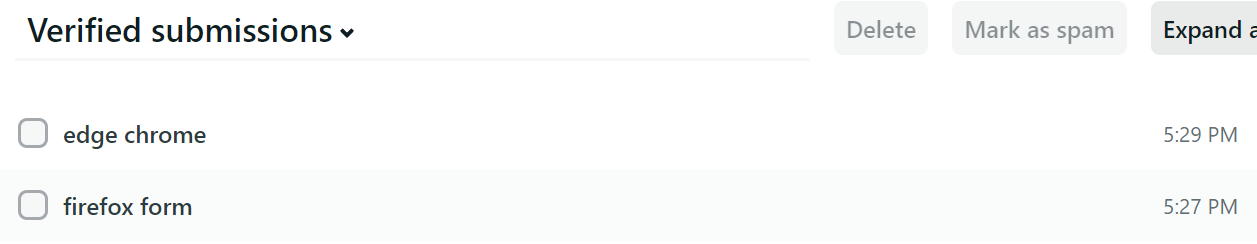

I have continued to try and debug this error today. Still no luck, but I have been able to uncover something that might help point out the issue. When I view the network submission in Edge/chrome I am able to see a failed record, right before a successful POST.
when I select this record, I see the following details (note, this information is not available in firefox when view Network tab, with preserve log checked.
Directly following this error, there is a POST which succeeds. Working for both browsers also…
So really, functionality is perfect, I just need to stop the error occurring JUST before the post, and the thank-you screen should be displayed. I can see it from the NETWORK tab:

Hi James & sorry to be slow to get back to you!
Looks like you got things working? I just posted to the form on your main page, the form was processed, and no errors were observed.
If that was the wrong form, please link me to the right one so I can take a look next week when our office reopens!
