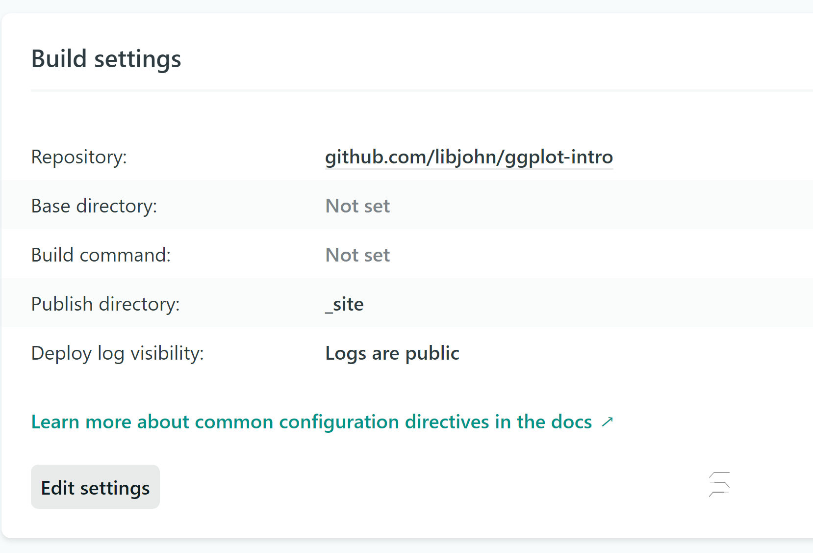

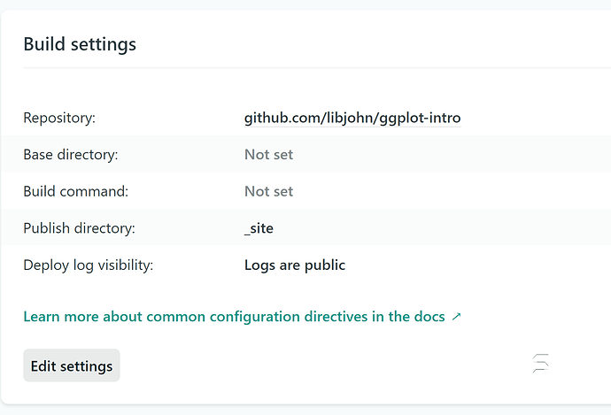

  • can you post a screenshot of your build settings please?
Yes to the first question. That is, I am manually building the site by running the render_site() function locally in RStudio. Then: staging, commiting and pushing the entire local repo to GitHub. The built site is in _site, a subdirectory of the git repository (and found in the GitHub remote.)
Here are the building settings
Thanks for looking.

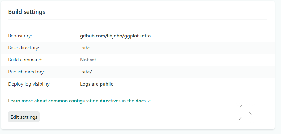

hmm. would you try leaving the publish directory blank, and instead, setting the _site as the base dir?

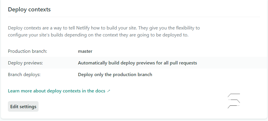

another thing to maybe check are the deploy contexts. You are deploying from master? if yes, then the branch should be set to master, for example.

Here’s what I tried this time.
  1. change build settings per your suggestion
I noticed, here, that the Publish directory value got filled in automatically and relattive to the Base directory value. Either way, it didn’t change the trigger deployment.
  1. I checked the Deploy context to make sure it’s deploying from master. It is.
see next reply for image

Deploy context

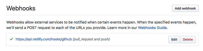

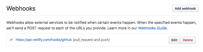

Could you check your webhook settings in GitHub’s UI, here? https://github.com/libjohn/ggplot-intro/settings/hooks
There should be a single hook, looking like this:
Assuming that is there, could you hit that “Edit” button and look at the VERY bottom of the resulting page at the transmission history? That should tell us a bit more about what GitHub has been telling us - and what we’ve been saying in response.
Thanks again for your help in troubleshooting!
