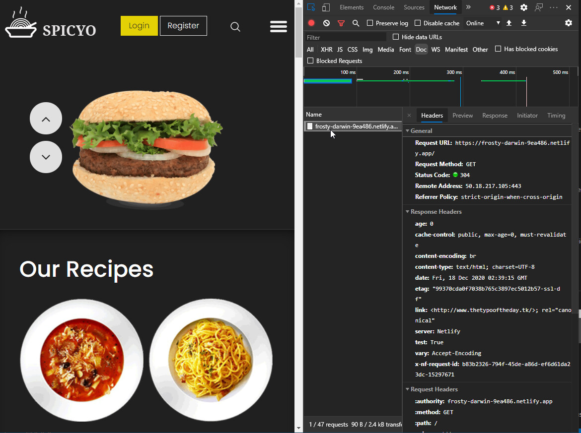

/* works, as you can see on the live site the response header includes Test: True.
The problem is that will apply to all URLs regardless of the the hostname.
I want to know if it’s possible to do it for a specific hostname.
