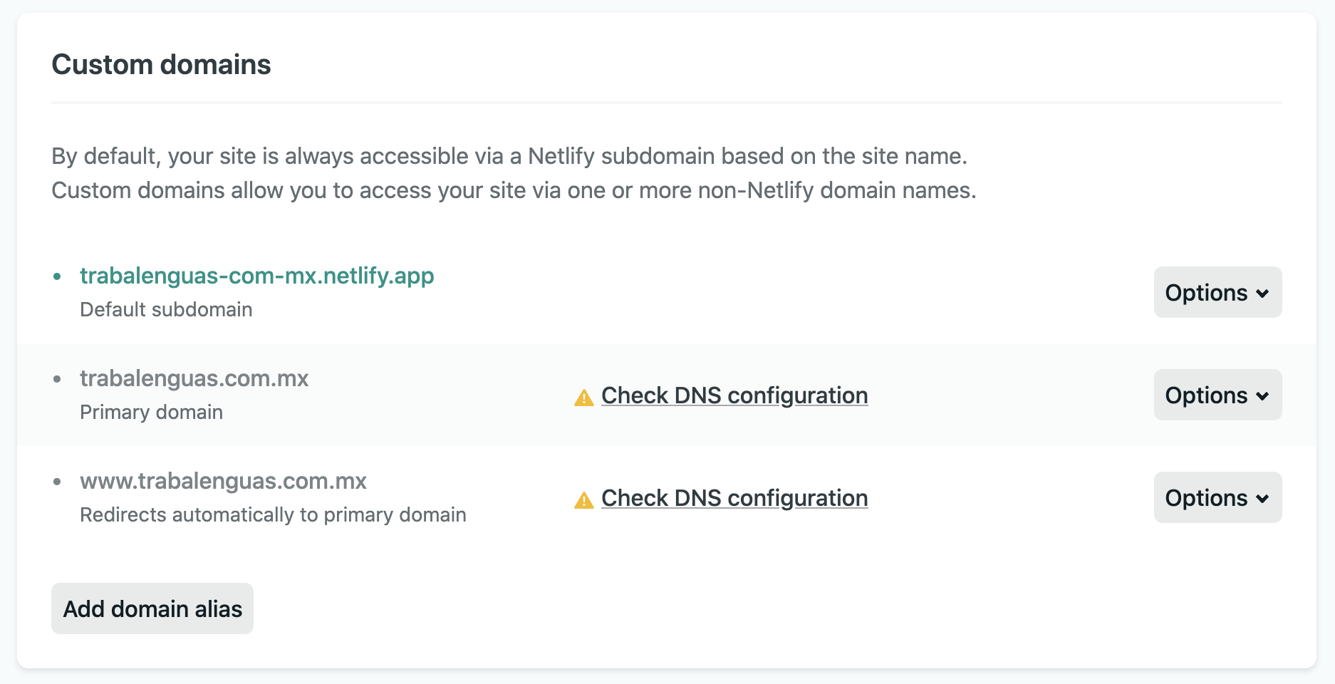

Hello all, in have one site under trabalenguas-com-mx.netlify.app with custom domain trabalenguas.com.mx the custom domain isn’t showing the site, looks like the DNS are wrong configured I have set the Nameservers in that domain as follow

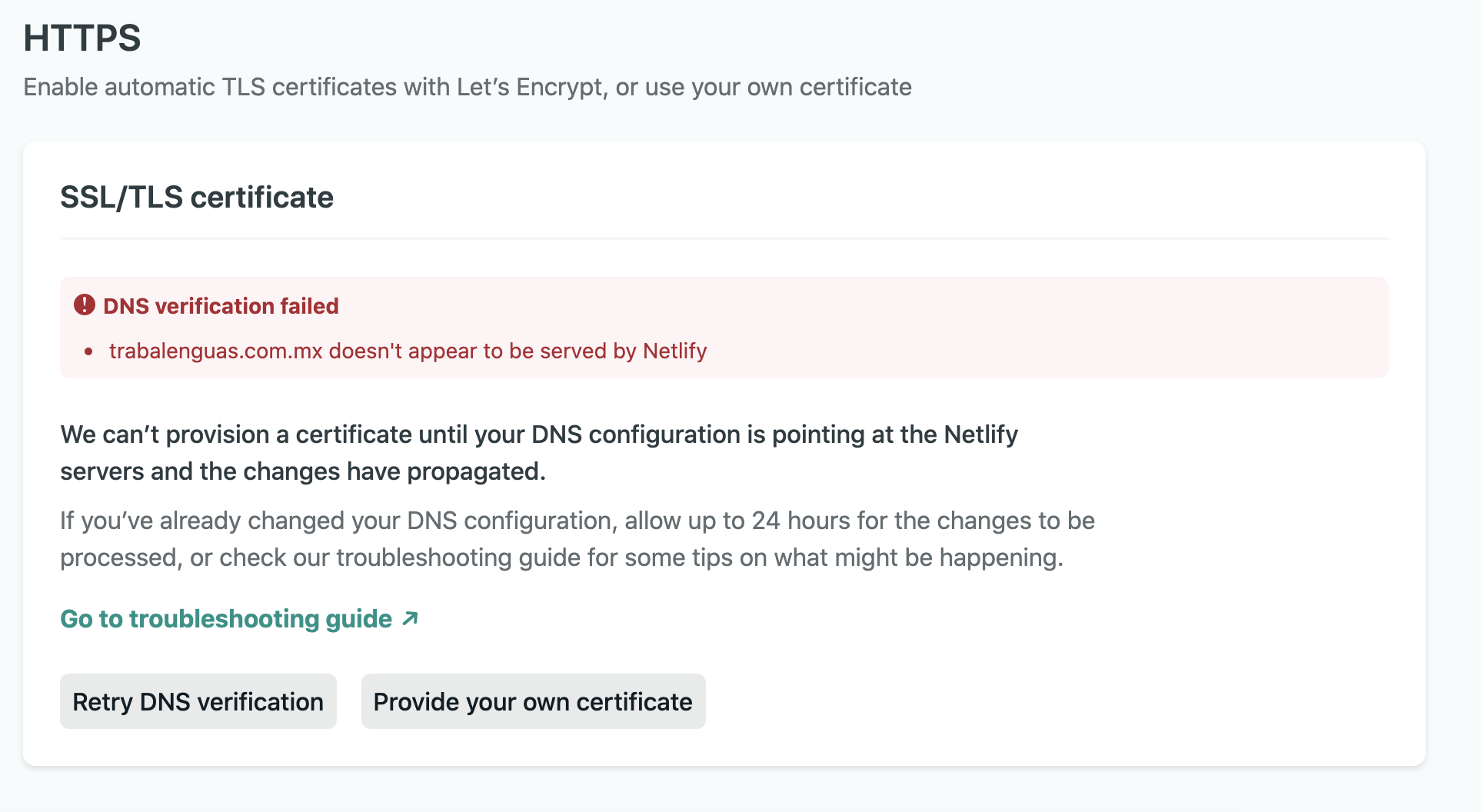

In the admin panel, I get an alert in DNS configuration
Can anyone help me in order to fix the issue in the custom domain?
@teracom You need to re-check the way you assigned DNS to Netlify, because none of your DNS records is showing up.
If the DNS assignment seems OK at your registrar, I would suggest deleting the entries and re-adding them … after double-checking that those are the correct name server entries for your custom domain.
Hi, @teracom. This custom domain does appear to be working now when I test (including SSL).
If there are other questions or concerns, please let us know.
Thank you, that’s correct, the domain had misconfigured some registers, now is working well.
