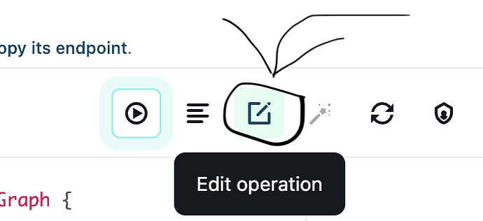

  4. After you’ve logged in click on the third icon which is the edit operation icon.
  5. Click on the Site & Authentication option. Kindly read the information on the Site & Authentication options page and then configure it accordingly to your site.
