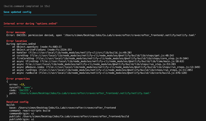

#2 - In trying to debug this, I tried to do a manual build from the CLI. I received an error response that I have not found anywhere else online.
For context, the relevant parts of my file structure are as such:
.netlify/
|— state.json
(note there is no netlify.toml file here. I tried creating one but did not have permissions. I called sudo touch netlify.toml and it made the file visible but that continued with the same issues)
