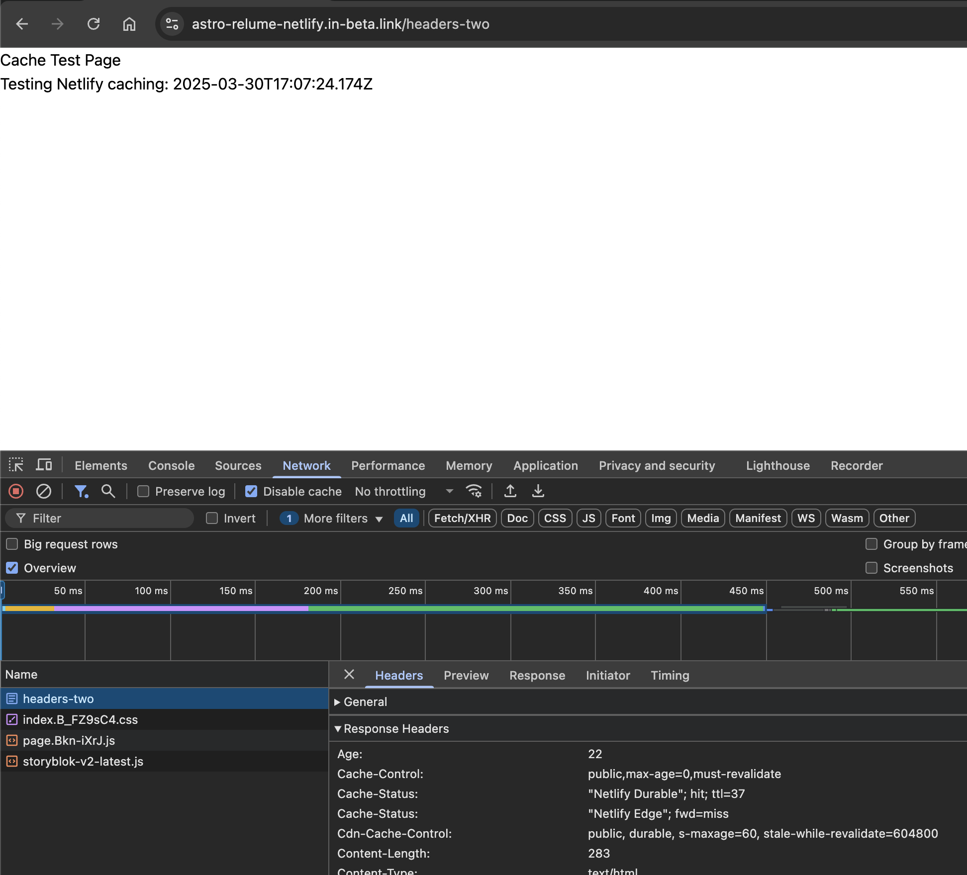

See this screenshot for an example of a cache miss (you can see the short age):
Between these two details, it makes it hard to buy into the stale-while-revalidate model if you’re using a short cache duration. If you’re caching pages for an hour, a few short windows of longer response time for a few seconds here and there don’t matter too much but if you’re using a short cache of a minute for example, there will be significant chunks of time where response times are noticeably higher.
