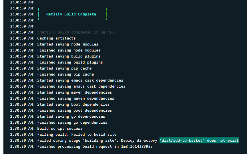

Anyway, I have tried a couple of the above examples that are not working and still, even changing the “dist” folder adding the project name (in the example attached is “add-to-basket”), the websites are not working and in the end the build is failing.
That is because the there is no /index.html file in that deploy. Instead the index.html file is the subdirectory convertitoretemperature as /convertitoretemperature/index.html.
The solution for that will be to change the publish directory to the correct directory. My best guess is that the publish directory should be dist/convertitoretemperature instead of just dist.

While reading all your hypotheses, I find out that, as I was supposing, the problem was my side, in my configurations.
The real problem was in angular.json file where I did not changed the project name: initially the project name was convertitoretemperature so all the references made by angular had that name. After some time, the project name was changed to converters but without changing it in angular.json. So, the build was successful but was generated in a folder that was not referenced in Netlify, as you have found.
Fixing the project names, and the others relative instances in angular.json, now the temperature converter project is working.
The same issue was also present in the other initially “non-working” projects that I have mentioned in the original post.

The answer is pretty simple and always depends on wrong configurations in the projects. In angular.json there is a node called outputPath that even without me touching it, sometimes is set to dist/ in the original working examples, in the originally wrong paths, it was set to dist/<project-name> (and the wrong project name, was the main issue explained in the previous post).
So to answer generally to the issue: the “Publish directory” in the “Deploy setting” on Netlify must mach the outputPath in angular.json.
