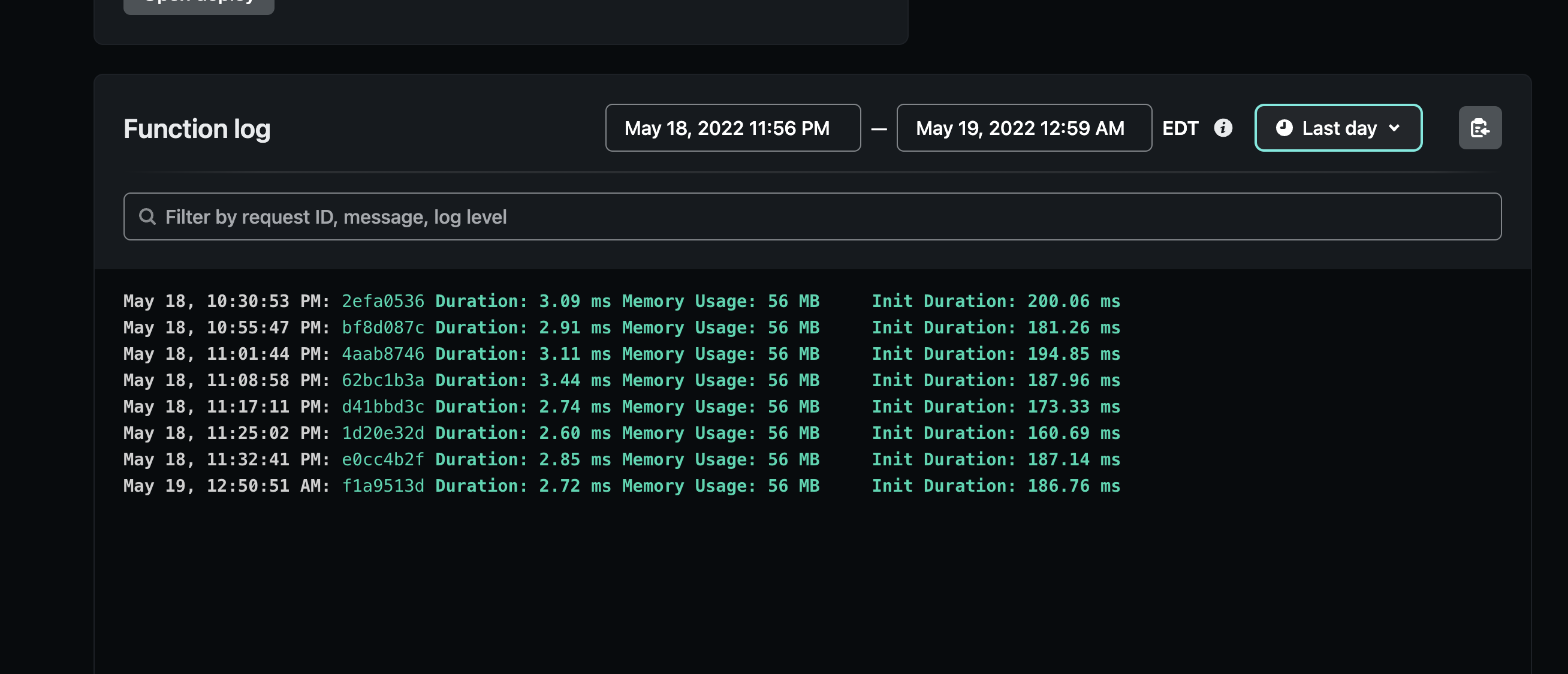

So I’ve deployed a deploy-succeeded function, and it appears to get hit at the end of the deploy, but none of the code runs. When adding console.log() statements, they don’t even show up in the logs:
Hey there, @ONeill45 :wave:
Thanks for following up with those details. I can see based on the photo above I can see that the functions ran for 2 to 3 milliseconds. This makes me wonder if the function is initiating and then closing immediately. Can you share your entire function file so that we can see how it is configured?
