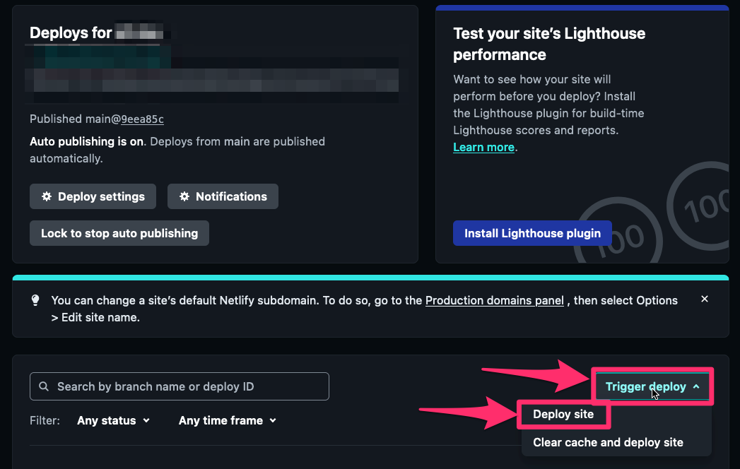

- If you know exactly when you want to build and are willing to trigger it yourself through our UI or via an incoming webhook, our Support team can enable a flag for your site(s) to skip all automatic builds from git, and use only the ones from your own custom webhooks which will still pull your code from git and perform a normal build.
I like the option of “trigger it yourself through our UI” - is this really possible and where does this trigger in the UI sit? The reason I’m asking is coz its not fully explained here, only the bit about webhooks is explained - “use only the ones from your own custom webhooks”
Hi, @zehawki. The button to trigger deploys is found under the deploy tab for each site. Here is a screenshot to clarify:
Ohk, got it. Its the same button, I was somehow thinking something new would come in.
So then may I request that the flag be set for all my site(s) to skip all automatic builds from git. (OR should I do this via email support)?
You can let us know the account slur or ID and we can make the change.
