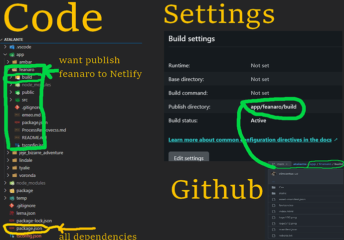

[react- cra TSX-worspace npm/lerna]
Errors
10:53:46 AM: git clone --filter=blob:none https://github.com/c0ncentus/atalante
10:53:46 AM: Preparing Git Reference refs/heads/feanaro
10:53:47 AM: Parsing package.json dependencies
10:53:48 AM: No build steps found, continuing to publishing
10:53:48 AM: Failing build: Failed to build site
10:53:48 AM: Failed during stage ‘building site’: Deploy directory ‘app/feanaro/build’ does not exist
10:53:49 AM: Finished processing build request in 3.329s
It should work ?
proof on github that build exist in the path mention (app/feanaro/build) (only one branch so I cannot be wrong)
If i put all dependencies in feanaro’s package .json =>
Why i use monorepo ? I delete 3 GB for putting react package and co on commun workspace lol.
Are you sure Netlify support monorepo ? (including commun package.json)

hi @c0ncentus
You don’t seem to have a build command set up:
You need to add this to match your local build command, I believe that’ll make it work :slight_smile:

I would suggest that to activate our monorepo support, you’d use a base directory of apps/ or packages/ - depending on what site you are trying to build. The usual way that folks lay out their monorepos is to “group” all the assets for the site into a subdirectory - and then start their build there (which the base setting does! - so if you have many sites under apps/ - you’d set apps/site1 or something like that as base).
Please let us know how it goes in that configuration!
