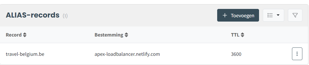

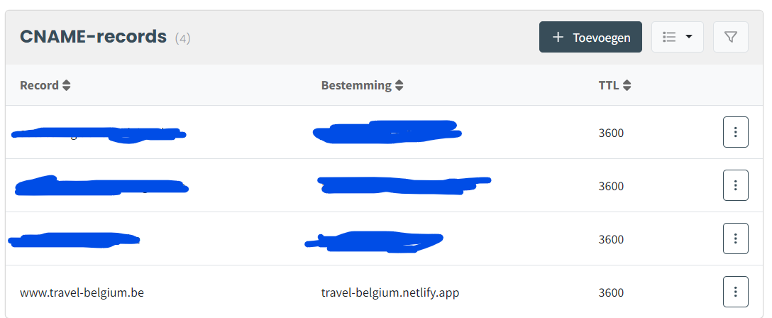

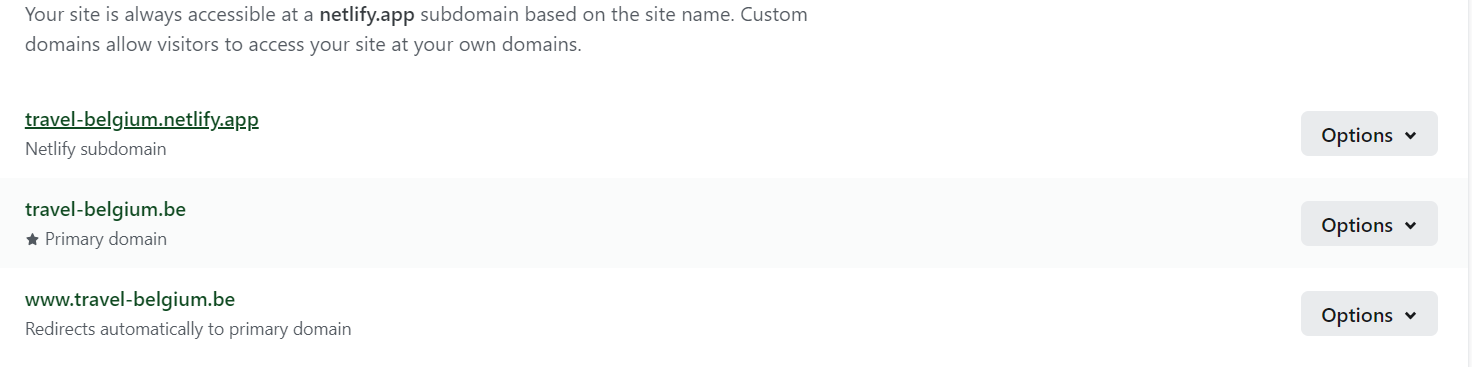

As Netlify doesn’t support .be domains yet I followed the instructions to use Alias on my DNS.
The site setting console seems to show everything went succesful (see picture, no error’s). And alias on my DNS system is also fine.
Yet the content on https://travel-belgium.be and https://travel-belgium.netlify.app is still different between old site and the new site.

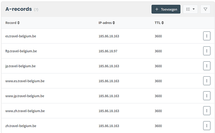

$ dig travel-belgium.be
travel-belgium.be.	4502	IN	A	75.2.60.5
travel-belgium.be.	4502	IN	A	99.83.231.61
travel-belgium.be.	4502	IN	A	185.86.18.163
Might have something to do with the extra A records. Delete records 2 and 3 above.

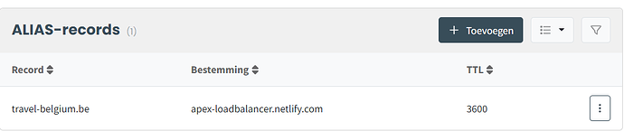

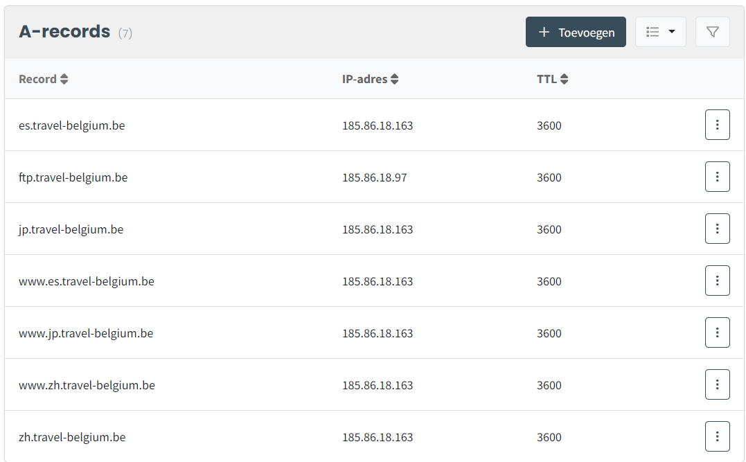

only found one extra A record in my DNS system, I deleted it now it looks like this
I can’t setup the domain-level dedirect because netlify doesn’t accept my domain as .be is not supported :smiley:
removing the extra A record seemed to have worked!
