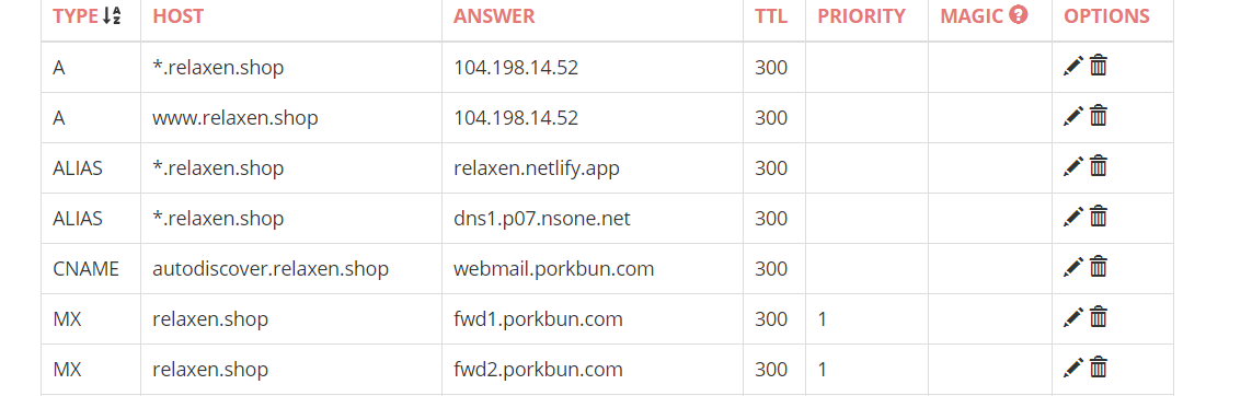

Hi, my site relaxen.netlify.app is live on my custom domain relaxen.shop and is accessible via https://www.relaxen.shop but if I go to https://relaxen.shop I get an error that site is not available.
Is there a dns record I am missing somewhere?
I have added to my host using the Alias so I believe should route correctly.
Thanks
hi there, could you pop a screenshot of your domain settings, please?

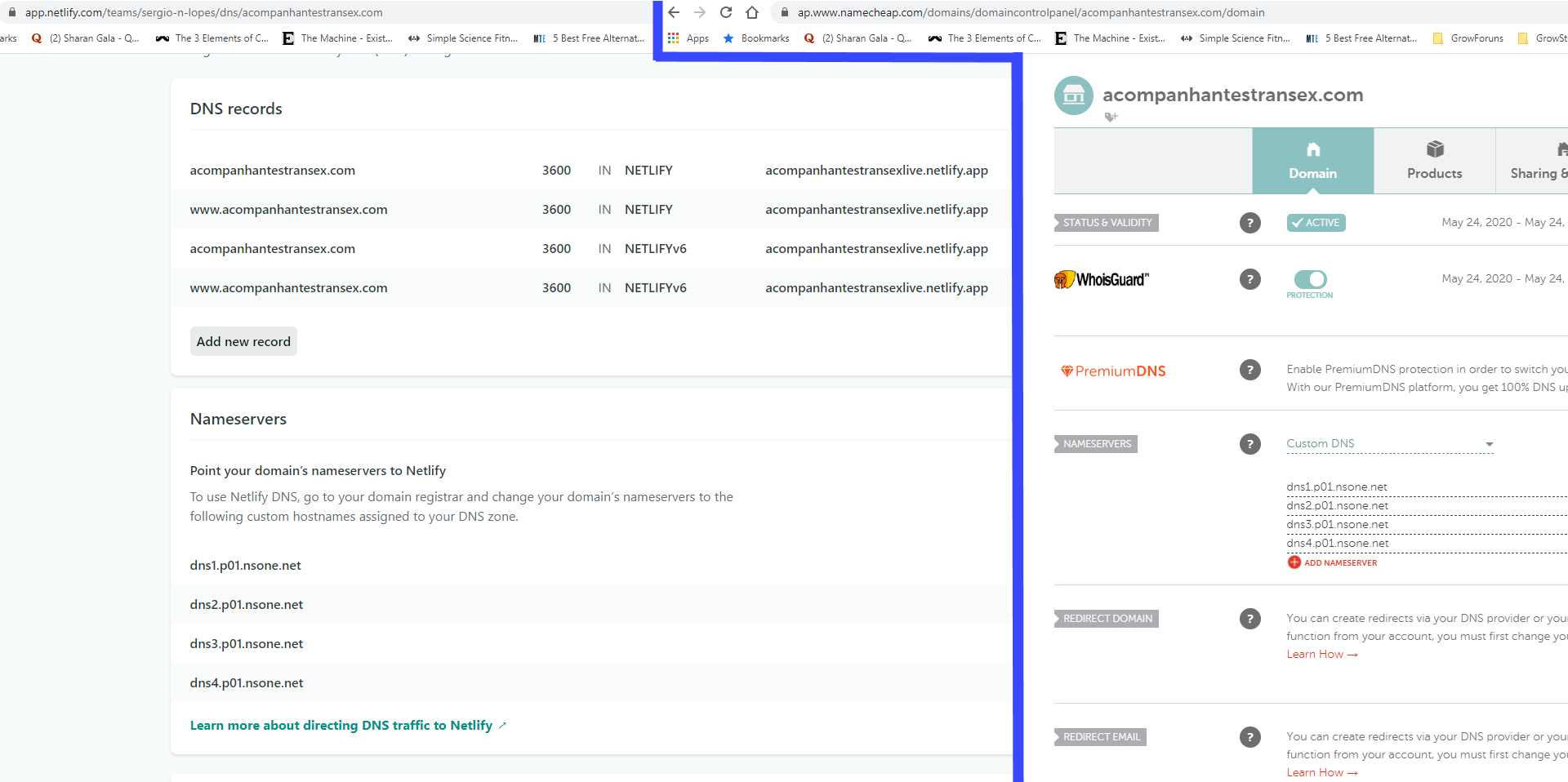

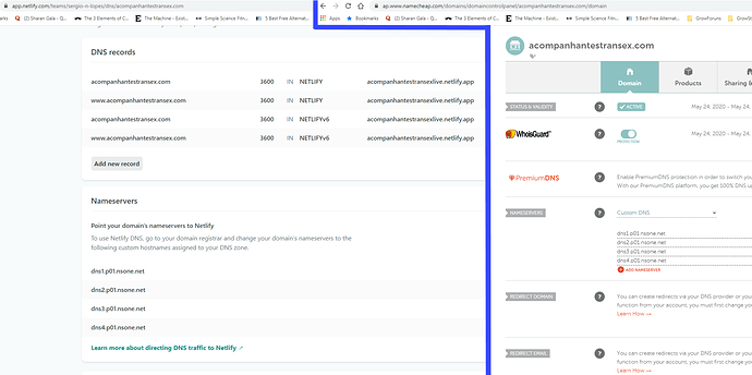

I must say I’m having the same problem (the other way around actually www works https:// doesn’t, with a different configuration. I just set the DNS servers
these are my configurations:
On netlify and on Namecheap:
(careful its an adult website)
edit contacted namecheap and they say they can reach it so it might be just a propagation issue (it has been just 24h)
seems to have worked thanks, have to say it’s a little complicated to jump between sections and find each step to configure dns, a simple step by step would make it so much easier
