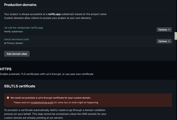

I can’t seem to be able to access my url after I connected custom domain.
Custom domain - roical.servmeco.com
When I access it shows error Site not found. However, it’s been more than 24 hours since we added the records to our domain service provider.
I’m not seeing this domain connected to any site - could you specify the site name?
I added custom domain to the netlify project.
This is the subdomain I have used roical.servmeco.com
You need to verify ownership of the root domain via TXT record before we can proceed with adding that custom domain to the site. This record needs to be created at the root level of your domain, so the name will be netlify-challenge.servmeco.com. Please make that record and give it some time to propagate and then you should be unblocked.
Now it’s working. Thank you.
For SSL/TLS certificate do we wait for few hours or do we need to do anything?
SSL certificates take some time to provision when waiting on DNS propagation. I can see we’ve since provisioned the certificate successfully.
