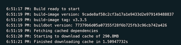

@luke Yes sir! I started 4 builds (I have 5 concurrent builds available) between 6.08PM and 6.20PM. Three of them failed after having a new (3x) and enqueued (1x) status, like so:
deploylog
The fourth only started building after the other three had failed at 6.51PM:
Schermafbeelding 2020-03-04 om 11.32.57
Schermafbeelding 2020-03-04 om 11.33.10
