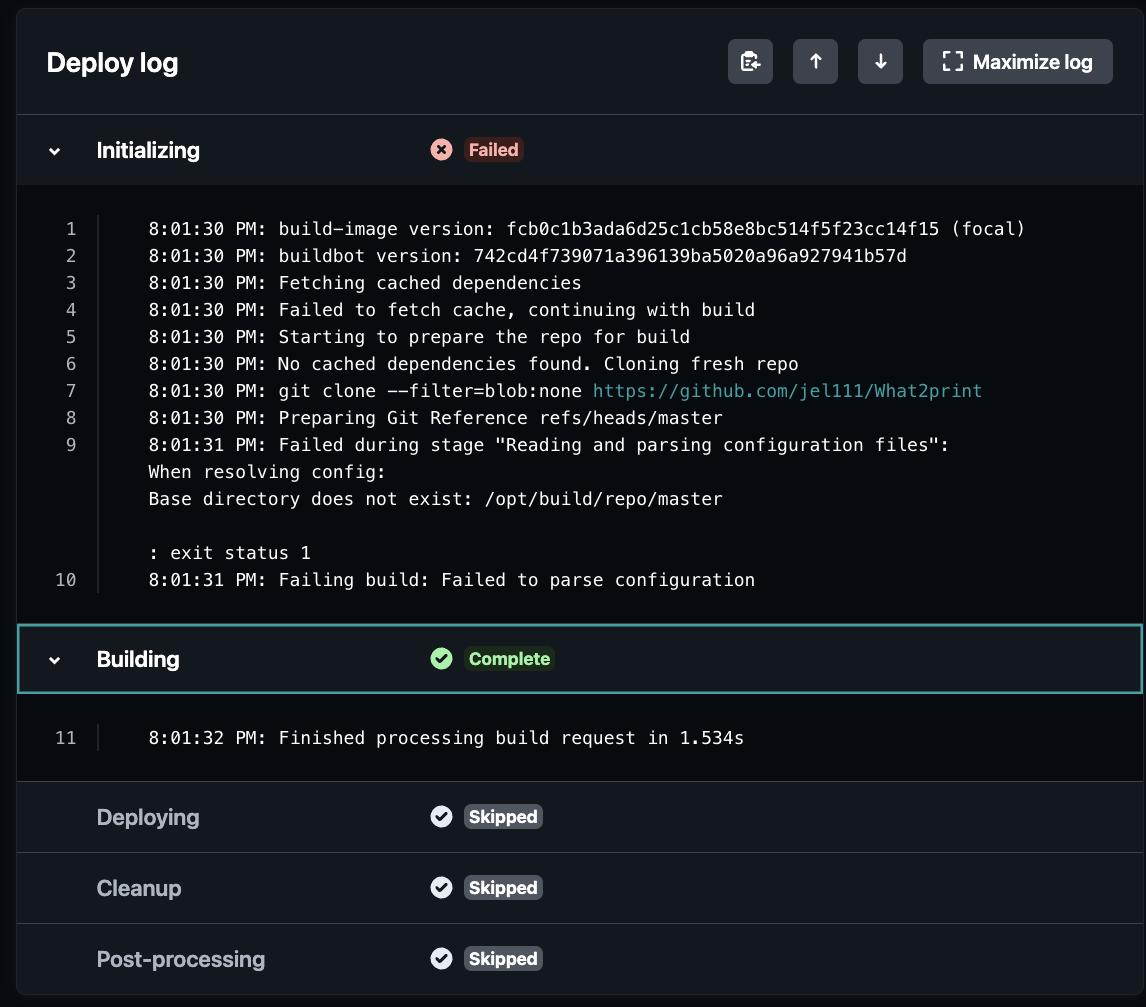

By the way I see in the failed attempt it says there is no Master file but there is one as it is shown in the Github repository.
I have no logs to post but took a screenshot of the failed attempt.
The reason for the error is evident in the screenshot you posted
This comes from these setting
Both base and package settings are incorrect as the code exists at the root of the repository and not in a directory called master.

@jel111 As some additional information.
Checking the Build configuration documentation you’ll see that Base directory has this explanation:
  • Base directory: directory where Netlify checks for dependency management files such as package.json or .nvmrc, installs dependencies, and runs your build command. The build system will use this directory to perform caching during the build process. If not set, the base directory defaults to the root of the repository.
You’ve input the name of your repository branch into a field intended for a directory.
As @dig has outlined, (and the documentation quoted mentions), you don’t need to specify a Base directory if it’s the root of your repository.
Thanks a bunch!
By removing master and leaving the field empty it built and deployed. I don’t know why that is so confusing to me.
In the docs they just mention the build and the publish settings and I was wondering why. It might be a good idea to say the other two should be empty if one deploys a default template. You know in case a dumdum like me comes along again. Highly unlikely I know but just in case. LOL
